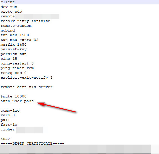

Next, grab a copy of your VPN provider's .OVPN configuration file. Make sure that this file contains all the settings you need, including the CA, CERT, and KEY provided by your VPN. (See Voxel's readme for more information.)
If the provider does not include your username and password in the configuration file, this may need to be added. The configuration may look something like this:
Auth User Pass
To add authentication to the file, change the "auth-user-pass" line to read "auth-user-pass /etc/openvpn/config/client/auth.txt" (without quotes) Then, create a text file with two lines -- the username on the first and credentials for the account on the second. (More comprehensive instructions can be found on Voxel's readme file if other portions are missing.)
