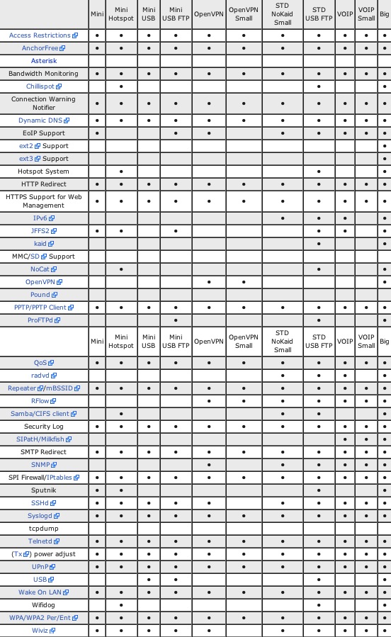

DD-WRT Versions
If you look around you will see several versions of DD-WRT. Although it may change in the future, here are the basic details as of the creation of this writeup.
DD-WRT Versions for the WGR614
From the DD-WRT Wiki for V24_pre_sp2 K24 these are the various Build Features and what is included.
Notes
(1)Official dd-wrt builds by Brainslayer
(2)Eko specialized Builds
(3)Smaller VPN JFFS builds are available for 4MB units: downloads/others/eko
(4)Only on DD-WRT v24 (8MB+ flash required)
(5)Apparently, IPv6-related features DO NOT work by default in DD-WRT v24. See IPv6 on v24.
(6)Not available on VPN-builds for v24sp1 (see prerequisites for JFFS).
(7) CFE Compressor needed to run.
For the WGR614 router what you would be looking for would be a firmware file named something like dd-wrt.v24_TYPE_generic.bin where the "TYPE" is one of the features shown above.
Keep in mind that WGR614 only has 4MB available to Flash. So when choosing a firmware make sure you choose one under 4MB.
