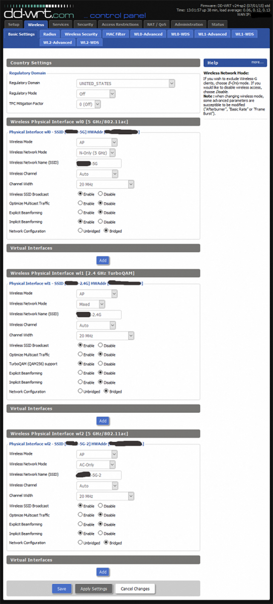

All the bands work fine with the stock firmware. The first 5GHz wifi band signal strength is very low or disappears in all the following firmwares except in the DD-WRT firware July 2015 release. Even in that release I need to reboot the router once in a while (~5 days) to have a better SNR as the signal goes down significantly. Sometimes the second 5GHz band goes down and I got to reboot the router again. I use WPA2 mode with TKIP+AES algorithm in all bands and have different SSID names for 2.4GHz, 5GHz-1, 5GHz-2. I tried the following versions and observed the same issue. Hope this is addressed in the next revision.

Setup is shown below
wifi settings
