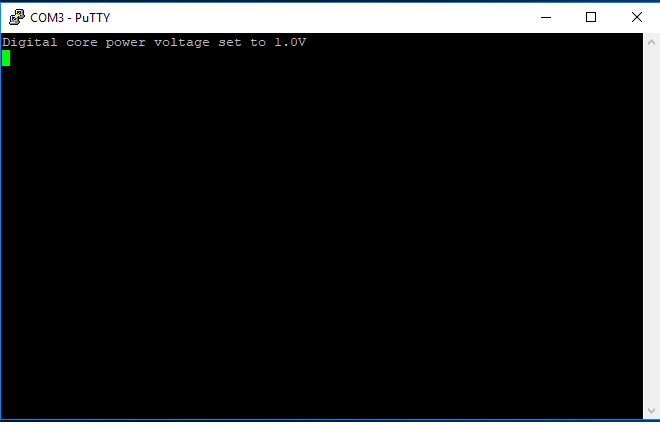

I have a similar problem, my
I have a similar problem, my R8000 simply stopped after restarting it, I am trying to access the CFE prompt but it does not exit the screen "Digital core power voltage set to 1.0V" I tried CRTL + C countless times, I tried rebooting with 30/30/30, and then connect, and I can not access the CFE.Do you have any idea about this error?
