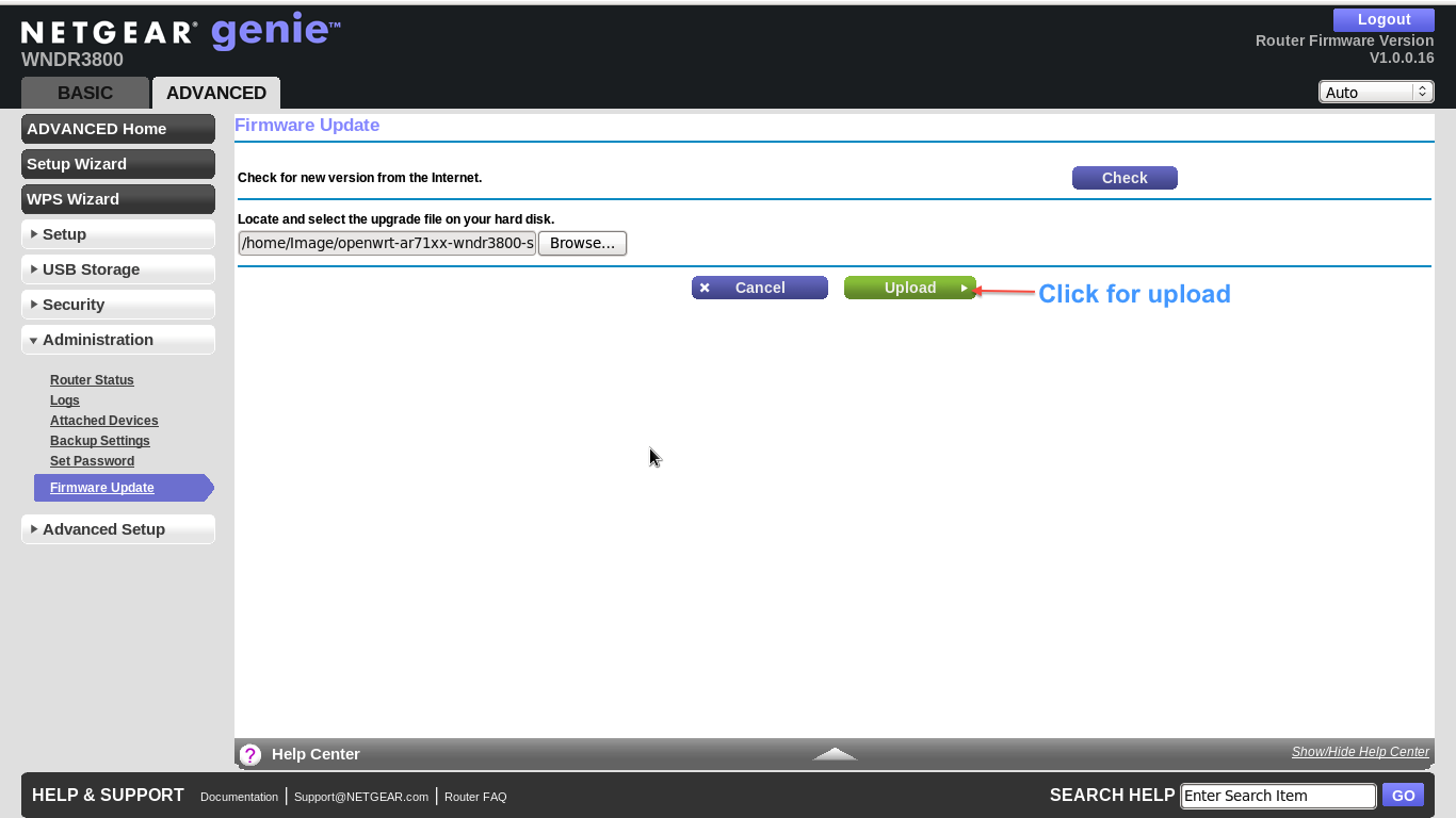

Type “192.168.1.1” in address bar of your browser to explore WebUI of WNDR3800.
Go to “ADVANCED -> Administration -> Firmware Upgrade” as shown in Figure 1.
fig.1
STEP 2:

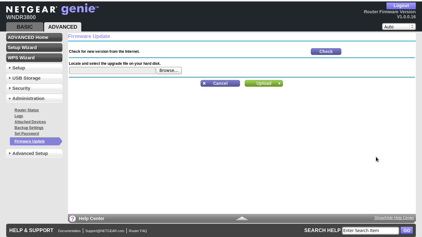

Browse the “img” file [openwrt-ar71xx-wndr3800-squashfs-factory.img / ddwrt-wndr3800.img / tomato-wndr3800.img] downloaded from MyOpenRouter site and click upload. (fig :2 & fig: 3)

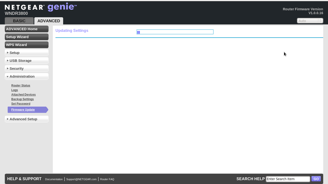

STEP 5:
Now the router should start uploading the target firmware. Wait until the image is flashed. You should be able to see the following pages successively.(fig: 6 & fig: 7)
fig. 6
fig. 7

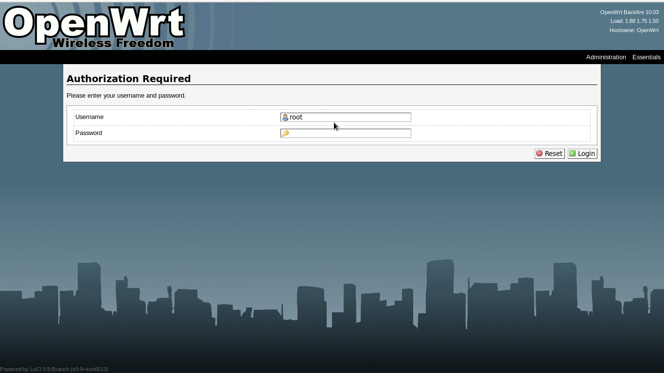

Now type “192.168.1.1” in address bar of your browser and hit enter to get the OpenWRT/DDWRT/Tomato WebUI page.(fig: 8 & fig: 9 & fig: 10)
OpenWRT:-
fig. 8
DDWRT:-
fig. 9
Tomato:-
fig. 10
** If you are having any problem in this step then clear your browser cache and repeat step 6.
Note: -
For OpenWRT,
- Default username : root
- Default password : void (the password field need not to be populated and click on the login button).

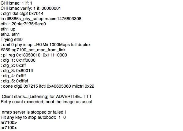

STEP 4:
Now to enter in boot prompt you have to perform the following steps,
i) Reboot your router.
ii) Hit enter when the message “Hit any key to stop autoboot: “ comes at the minicom screen. (You will be given 1 second to hit the enter key, if you don't press any key meanwhile the router starts booting automatically).
Following picture (fig: 13) depicts how your screen will look if you are able to enter boot prompt.
fig. 13
