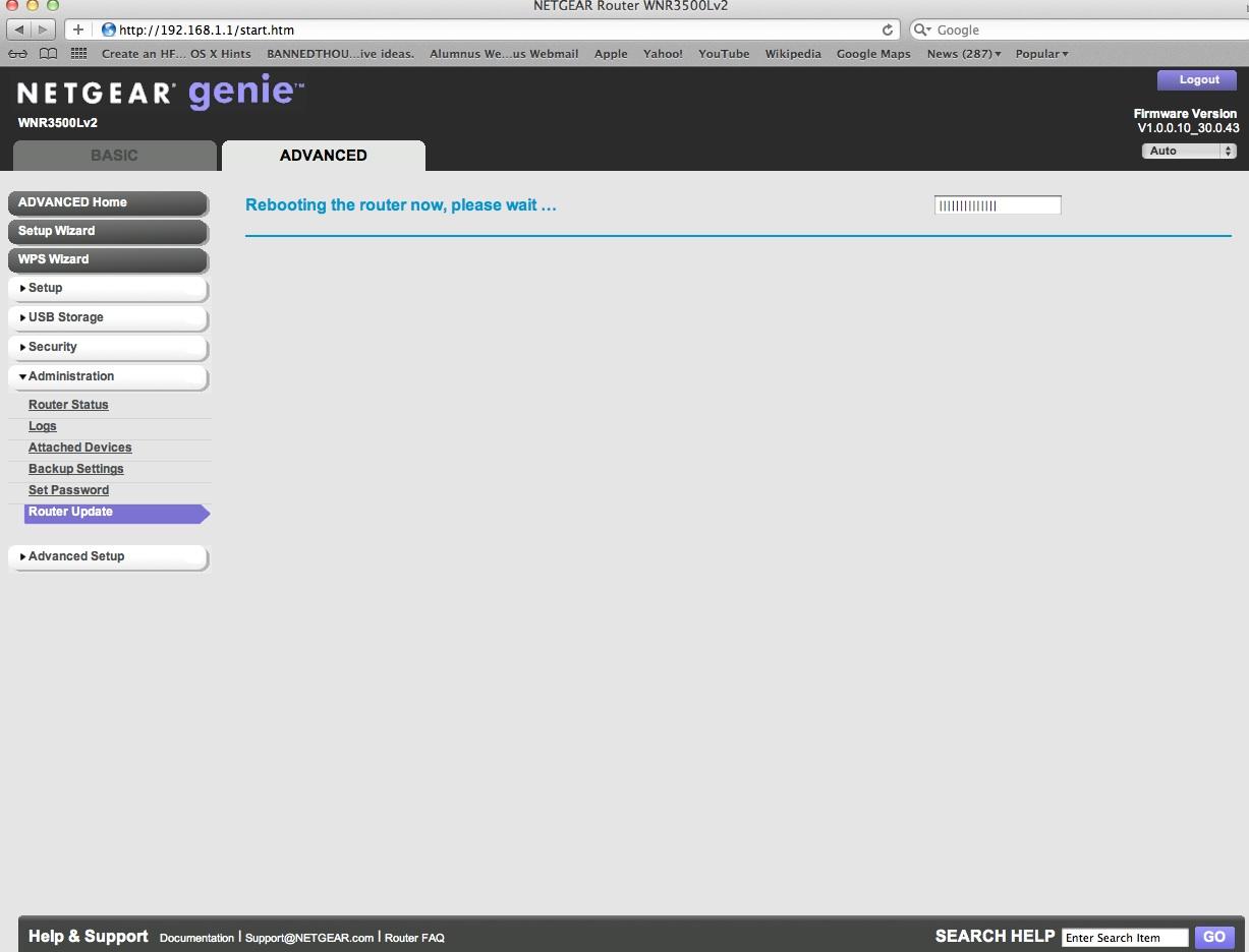

Step 5:-
Now the router should start uploading the target firmware. Wait until the firmware is flashed. After flashing your router will reboot with your target firmware (Fig. 6) Wait until the progress bar completes..
fig. 6
