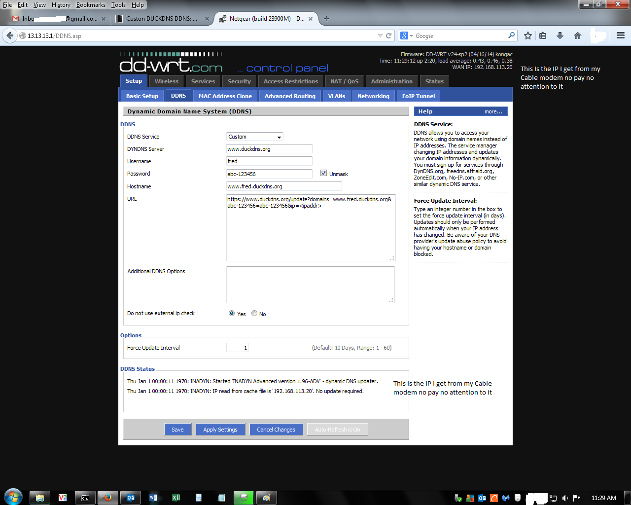

Hi guys I just wanted to share my settings with you all for https://www.duckdns.org
I do not have an external static IP address so I am faced with the problem of having an ever changing IP address. I wanted to connect remotely to the router via a domain name and started to look for free and working service.
https://www.duckdns.org is not one of the more popular DDNS servers but it is free and I wanted to try it.
After numerous attempts at the settings I finally got t to work without the use of a script.
There is support for DDWRT and tomato on the site but personally I find it is limited.
You must go to https://www.duckdns.org and sign in with your Gmail account then use picture as a guide to get it to work.
If is is not working jsut change the option Do not use externat IP check.

Using the info you gave try this
DDNS Service - Custom
DYNDNS Server - www.duckdns.org
Username - fred
Password - abc-123456
Hostname - www.fred.duckdns.org
URL - https://www.duckdns.org/update?domains=www.fred.duckdns.org&abc-123456=a...
Force Update Interval - 1
I also have a sheduled reboot everday

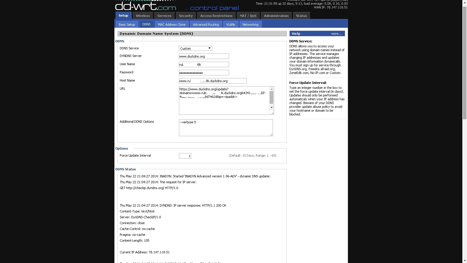

Thank you so much. I realise you went to a lot of trouble to produce that screenshot for me and that picture was worth a thousand words.
I attach a screenshot after inputting your information. I notice that, scrolling down to the DDNS Status section, the following is listed:
Thu May 22 21:04:27 2014: INADYN: Started 'INADYN Advanced version 1.96-ADV' - dynamic DNS updater.
Thu May 22 21:04:27 2014: The request for IP server:
GET http://checkip.dyndns.org/ HTTP/1.0
It refers to dyndns.org and not duckdns.org. I wonder if this is some sort of snag in my version of DDWRT.
I keep logging on to the DuckDNS websits and looking at my current ip, which remains out of date, and, given the above, it might be no wonder!
Any comments or ideas?
Once again, thanks for the trouble you went to in producing that excellent screenshot.
Martin
