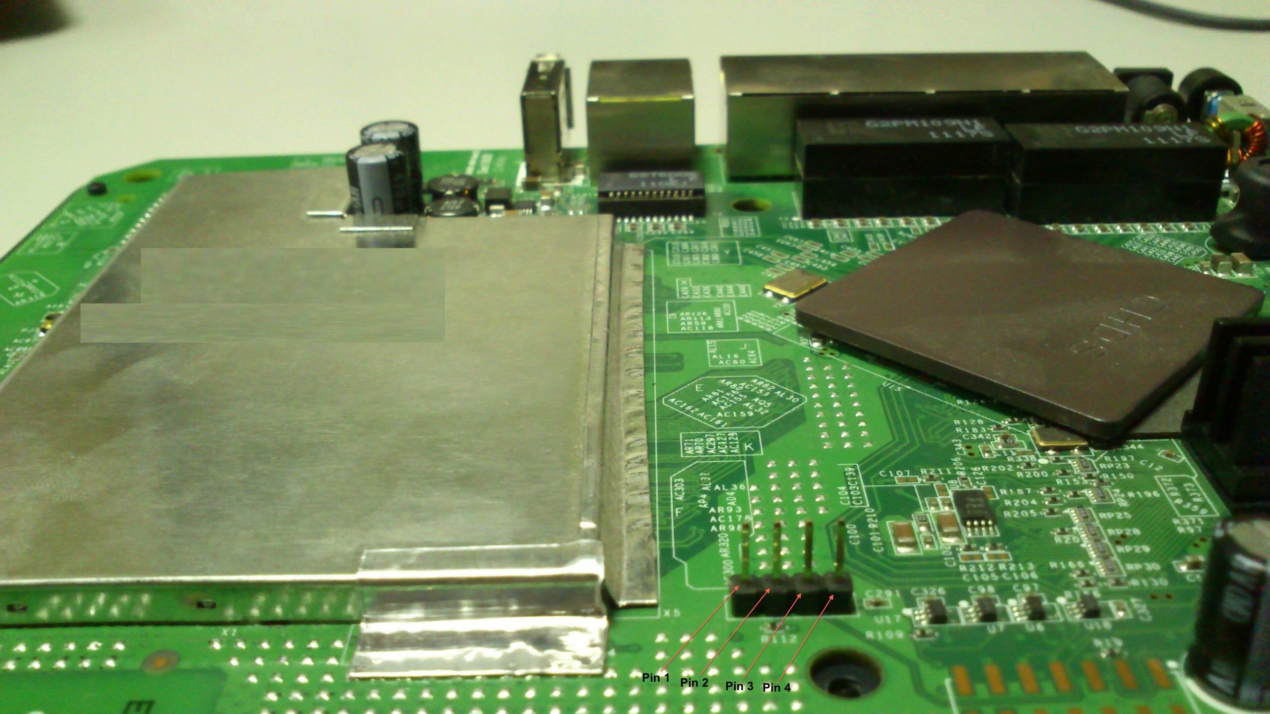

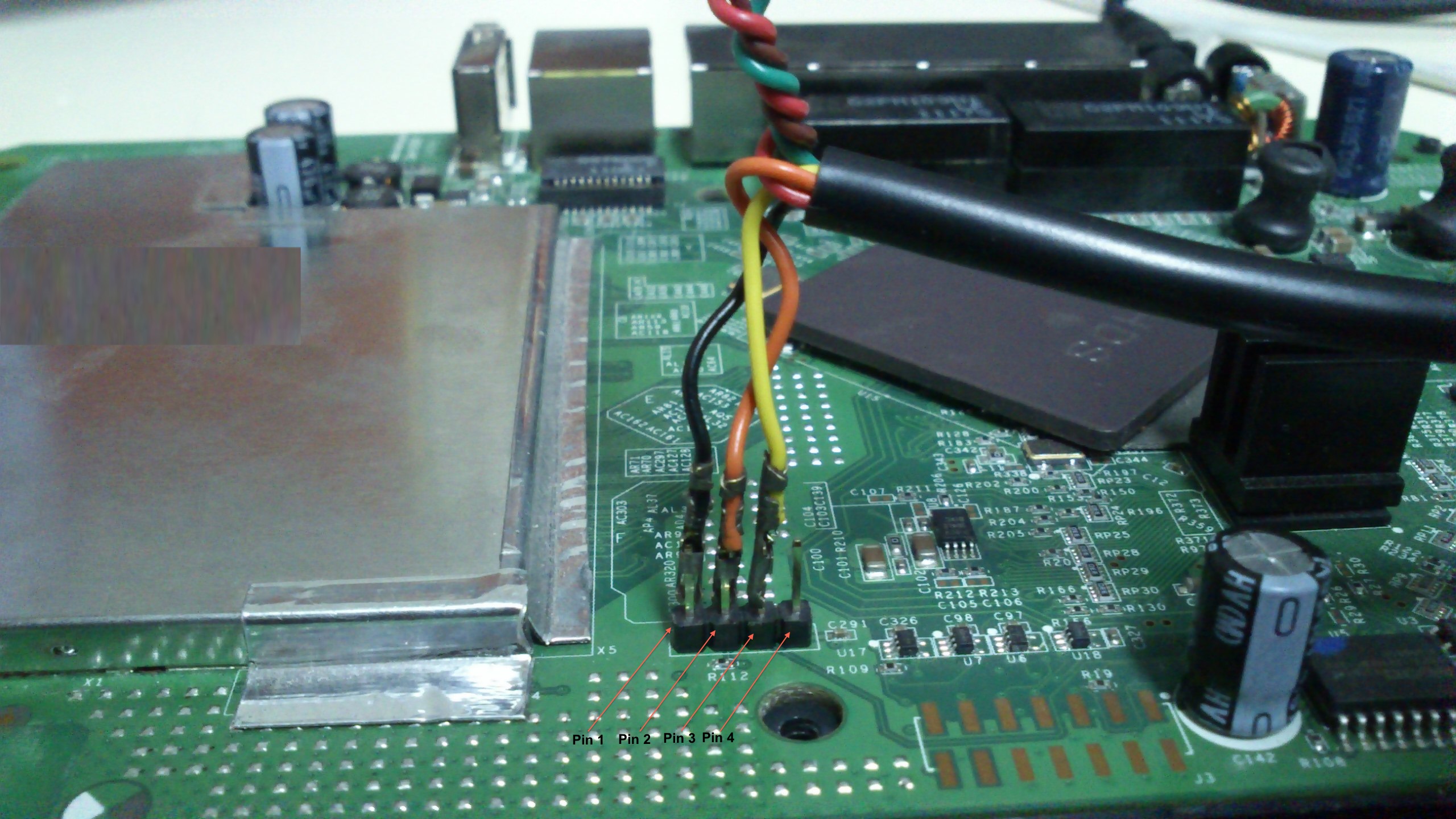

Do you have some pics of the connectors with details of each? I will be getting one next week and setting up a serial cable for it.
The following pictures explain the pin connetions. You can use the same serial cable as that of the WNR3500L.
