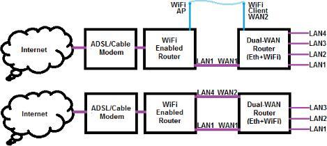

I think you can enable testing Dual-WAN a number of ways with just one Internet feed. The following two network topologies should work if you used static addresses / VLANs on the routers.
Both of these setups should allow you to route Dual WAN traffic to one real internet connection, for dev/test purposes:
Just test out the Static/DHCP/PPPoE/NAT parts afterward with one WAN link at a time. You could insert a 3rd Wireless router as a WiFi client(w/NAT on the LAN side), in the first picture, if that helps with testing PPPoE/DHCP/etc. + Dual Ethernet WANs all at the same time. Finally, you can test link failover, load-balancing, etc. by disconnecting or interfering (nearby Microwave ovens interrupt 2.48GHz WiFI links) with one of the WAN* ports when both are active.
Something like this should enable anyone to test out or develop UI for Dual-WANs (if they are already skilled with HTTP, VLANs and routing). The payoff here is that it would be possible and probably easy for anyone with your most excellent firmware to set up one or more failover / backup links -- this is of significant value if you are relying on the internet to be up for VoIP(especially 911), self-hosting HTTP servers, P2P file sharing, multiple FTP clients/servers, accessing your workplace, or any number of other scenarios where need high reliabilty and/or more aggregate bandwidth using multiple links for home or business use.
