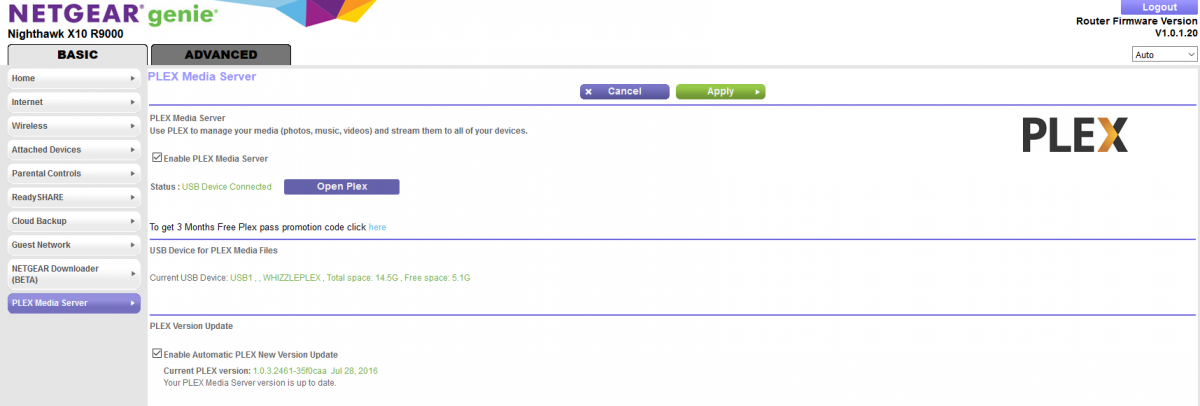

First, Plex needs to be enabled on the router in order for it to begin working. The first step is to attach USB storage, preferably a device that has enough space for the media you want to store (photos, videos, music, etc.) and also supports the faster USB 3.0 standard. Once the USB device is connected, head to NETGEAR Genie (http://192.168.1.1) and click on the Plex Media Server tab.
After clicking the "Enable Plex Media Server" checkbox, Plex may begin to download and install on the router. Also, ensure that the "Enable Automatic Plex New Version Update" box is checked; this will tell the router to update the Plex server to the latest available version for the R9000.

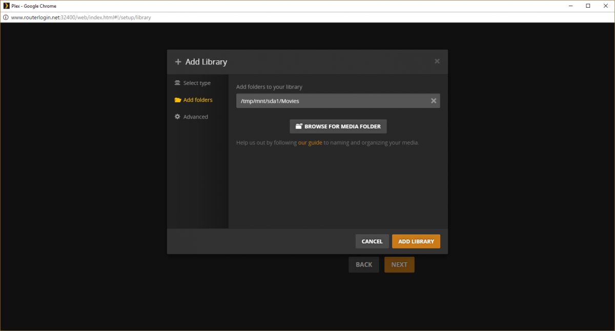

Plex will detect that the R9000 is running as an available server and guide you through the setup of your first library. The server can have multiple Plex libraries, and it's easy to create a library for each media type, e.g. music, movies, and so on. This guide assumes that media has been added to the attached USB drive and that it might be organized into folders, such as /music and so on. In the example above, we've selected the Movies folder on the USB drive that is attached to the router. The mount point may be unusual looking (ours was /tmp/mnt/sda1/Movies in this case) but should be simple to locate. Then, the media type is selected.

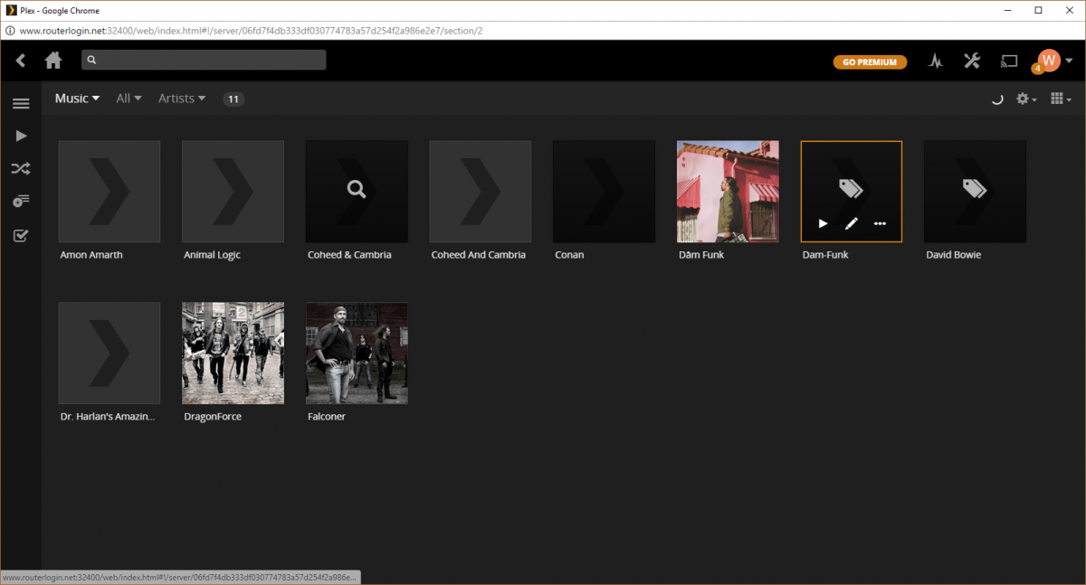

Very shortly after, we were able to access the music located on the USB drive in the appropriate Plex library that was created in the initial steps. Depending on the settings, Plex will automatically download images, album covers, and metadata -- and this process starts with the default settings right away. The moment libraries are added and the terms accepted, the Plex server inside the router begins "doing its thing."

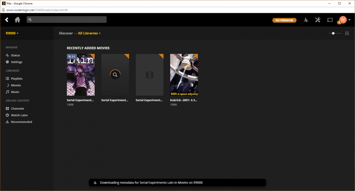

Here's a shot of our small test movie library -- Plex can be seen downloading the appropriate metadata. Encoding and other tasks are also handled by Plex, and even though the movies on tap were of several different formats, all streamed right away with no difficulties.
