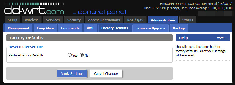

Step 5: Log into DD-WRT and perform a reset to default settings.
DD-WRT Factory Defaults
After the flash is complete, log into DD-WRT through a browser by typing 192.168.1.1. Generally, DD-WRT will prompt you to enter your desired username and password to proceed; make note of this in case you get bumped out of the interface. Once in the DD-WRT screen, click the "Administration" tab, then "Factory Defaults." Select to restore to factory defaults, then proceed. Once the router reboots, you should be good to go with your first installation of DD-WRT!
