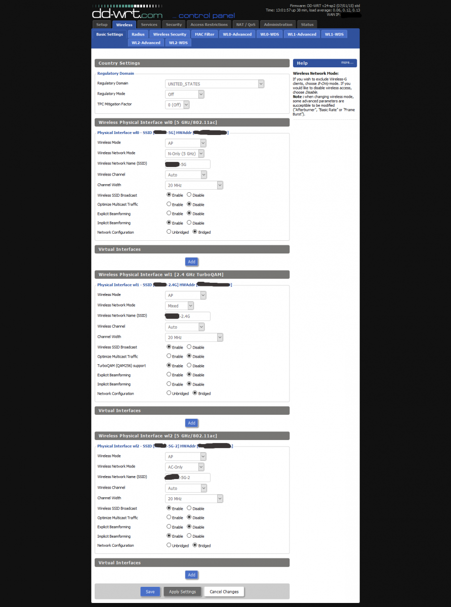

Setup is shown below
r8000 wifi settings

Solved:
Solved: I still had similar issues (wl2 disappeared) with the latest build (DD-WRT Kong Mod for NETGEAR R8000 2017-01-18). I followed one other user's comment (steps given below) and fixed this issue. Now all wifi bands work fine and also signal quality is 100%.
Important: This process would erase all your settings and put the router back in default settings. So backup your settings (Administration-->Backup) before doing this, so you can restore it latter. Also I have only tested this on R8000, so for other models, it might do different. Once you do the following, either you can load your old settings or recreate your settings fresh. Just to be thorough, I recommend recreating the settings so it does not have any conflict from your old settings.
Steps:
First I had installed the firmware "DD-WRT Kong Mod 2017-01-18 version" following the usual process (factory default settings, update firmware with reset to default, then reboot again). Now did the following steps:
1. Go to "Administration-->Commands"; copy and paste the following commands in the command box then click "Run Commands". This would erase nvram and would reboot the router.
erase nvram; reboot
2. Go to "Administration-->Management"; Scroll down then click "Reboot Router" to do an another reboot.
3. Now you can customize your settings and enjoy!
