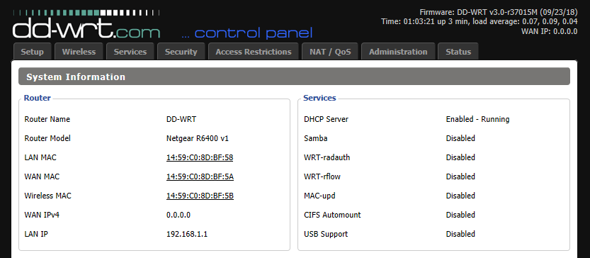

Hi all,
I have just bought a new Netgear R7000P, and I have just uploaded the new Kong firmware from http://desipro.de/ddwrt/K3-AC-Arm/dd-wrt.K3_R7000P.chk and it flashed fine, and I was able to access the  dd-wrt interface.
However, when I look at the System Information it shows the Router Model as Netgear R6400 v1 .. which worries me.
Which is the correct firmware to use with the R7000P ?
Is this a known issue?
What are my next steps?
Note, I have already bricked one R7000P when I then attempted to update the DD-WRT firmware with the file - dd-wrt.v24-K3_AC_ARM_R7000P.bin.
Any assistance appreciated

See https://forum.dd-wrt.com
See https://forum.dd-wrt.com/phpBB2/viewtopic.php?t=317434.
TL;DR
Enter and 'Run Commands' the commands nvram erase && reboot in the Administration -> Commands -> Command Shell -> Commands.
Afterward you need have to reconfigure your router.  Note, you'll probably need a newer release of the firmware.  I got mine from
http://www.desipro.de/ddwrt/K3-AC-Arm/TEST/
