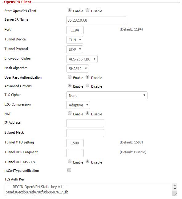

I have a standard default config openvpn running on a Google Debian instance which works as expected on my PC, Mac, and phone (Android).
I have DD-WRT (build 33555) on a Netgear WNDR4300 (atheros 1s) with entware.
I configured the DD-WRT VPN client using paramaters from the working ovpn file that is use successfully on the other three "devices".
However the only thing I can ping or access is the VPN server itself. DNS resolves, but I can't get to anything else.

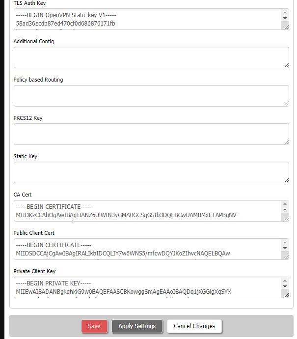

I set to keys from the ovpn file for these:
TLS Auth Key
CA Cert
Public client Cert
Private Client Key
