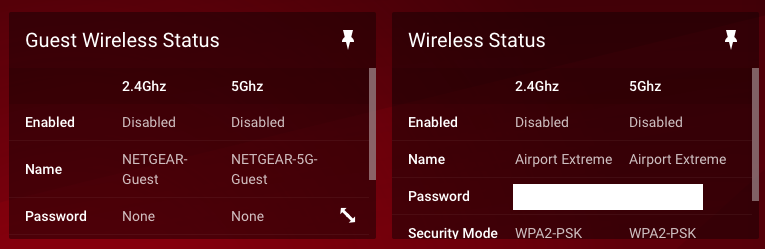

I have noticed that in the dashboard, only 2.4 ghz info is given and not the 5ghz in the wireless status.
Is smart connect enabled? IF so, disable this and check.

What browser are you using? I'm seeing both sets of networks, main and guest network.
Chrome and IceDragon.
I was using IE11 and Opera. Showing both radios for both networks.
I tried IE11 but made no difference.
Guest network shows both bands but the main shows only the 2.4ghz.

Using IE11 or Opera, I see both networks, both radios.
I found my problem. The reason only 2.4 was shown, is because my wifi password was too long. I shortened it and now it shows both bands.

You might try the following. Revert back to stock FW. Do a factory reset on stock FW and go in and check to see if both radios appear there. they should be enabled by defaut. If so, re-load the conversion FW again. After loading and clearing out browser caches, see if the radios appear correctly or not. If not, do one factory reset and set up from scratch. Check again. SHould be there...
AH, I didn't see your latest post...glad you figured it out and it's working now.
How long was your PW?
The full 86 characters.
wow. ive never used that long of a FW. LOL 5-6 is all I use.
